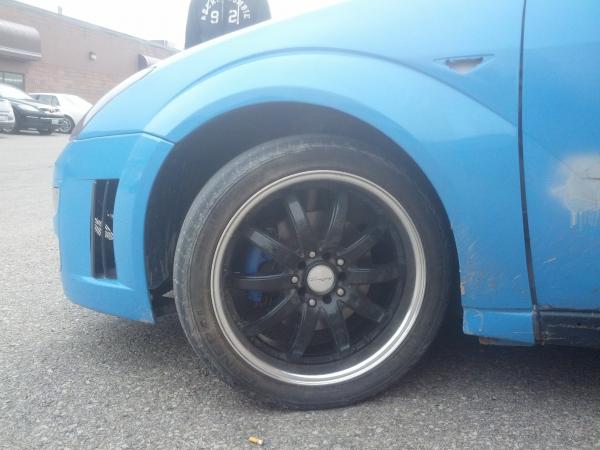

Couple sneak peeks for my 5-lug
Sooo ive given up on the mazda 3 knuckle all together, as its impossible to mate a mazda3 outer CV with a ford inner without custom made shafts, so I went and welded up the stock hubs and remachined out the 5 x 114.3 pattern in its place, using early 05 knuckles to keep my struts, upgrading balljoints, and using mazda 3 front calipers/brackets with the mazda3 front rotors. I have the rotors at work crossdrilling them for shits and giggles right now, so theyre not in the pictures yet.

So you welded up the 4x108 holes and re drilled 5x114.3 ?
There should be no problem with the holes that close. Even if the material cracked, it wouldn't open up to allow the studs to go anywhere. And yeah, welded up the 4x108 and went 5x114.3. It was probably the easiest because of the Mazda 3 brakes being extremely similar to the 05+ focus

Well, rim selection - I'm also going rs widebody, so finding 4x108 rwd offset rims are few between, second- love doing something different on a very modded platform. The focus hubs are sorta weak under extreme conditions but they'll be fine for mild use. If need be I'll have to make another set out of stronger material. So far the only thing that wasn't straight forward was making hub centric rings for the Mazda 72mm center hub for the rotors.

That's awesome. I can totally tell that a set if red offsets will work wonders. I have a kinda crappy set of 17" fwd rims that I'll be using spacers to start with- only cause the price was right. I'll have some shots of the rear brakes from a Mazda 3 ready to go tonight.

In all honesty, 10" disc and 9" drums look pretty putrid under any sort of rim. So this is an upgrade all around. Now I can use stock mustang rims or aftermarket, used being plentiful for cheap. Plus now I own a focus you cant pick off the shelf Smile

I can see the different options, trust me I've researched. I only had stock zx3 brakes to start with, so I upgraded to early 05 knuckles to use the Mazda brakes. I'm also cheap as hell and have so far spent much less than factory zx3 brakes would have cost, getting parts from pick and pulls, and doing all the work myself. And by off the shelf, I mean things you can order that already work together. I know you can't buy or order 5x114.3 hubs or hub->rotor centric rings, the rest is easy. Besides I don't plan on buying $1000 rims for a car I bought for $600 Smile
