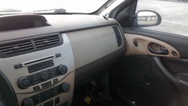

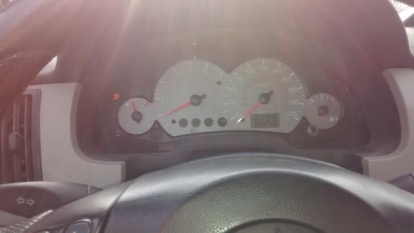

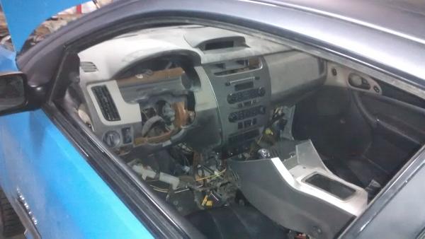

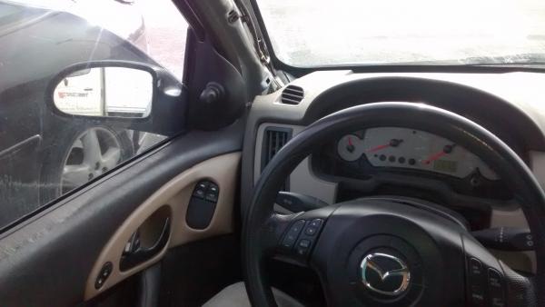

Just so some crazy people like me know, the 08+ dashboard fits perfectly, frame heaterbox and all into 2000+ cars with no physical modification. The steering columns are different so I reused my 2000 and welded new studs onto the frame. Wiring on the other hand.... Its a bitch. But its possible. I have the radio, heater controls and display working. I had to use my 2000 cluster cut up a bit to fit though. This cars bus isn't can bus like the 08+, so the cluster won't work.

The 08 has pillars that only go to the headliner, which almost snap into place, so I'm going to cut a set of stock 00 ones where the 08s left off to cover up the seam. I only have the passenger side one from the 08. I didn't grab them till one was already gone.
And it does suck about the gauge cluster because the newer ones look way cooler. I'm thinking of using a tablet and an odb2 reader and the torque app as a cluster in the future. Or a custom app. The only thing I'm unsure of is the fuel level.

Hey man! And the wiring harness from the 08 I had to strip down to the bare heater/radio/display wires that go to the 08 smart junction box, and hook it up as a second separate system. So this is by no means plug and play lol. If Anyone wants to do a swap like this I can give help and all the Mitchell wiring diagrams. I ended up with a harness with power, ground, ignition, accessory and blower motor power wires and two fuse boxes lol
