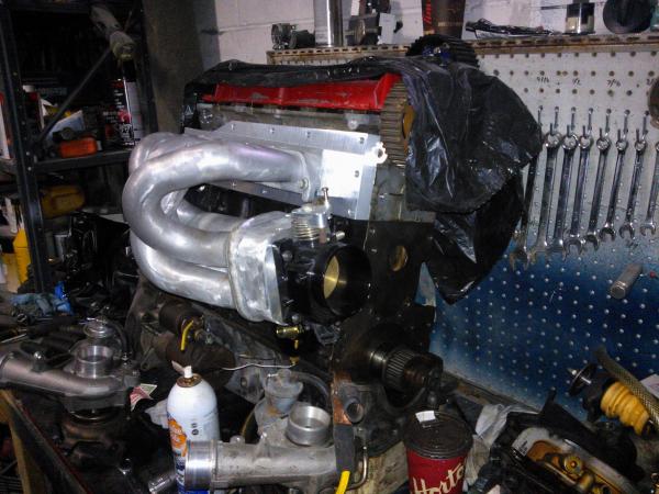

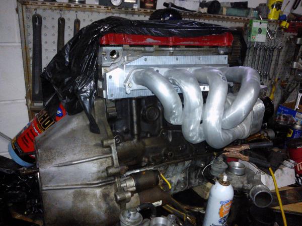

I had a chance after work to fab up a bit of my intake adaptor, so far so good, i still have a bit of engineering to do to make it more usable and to clear the oil filter.

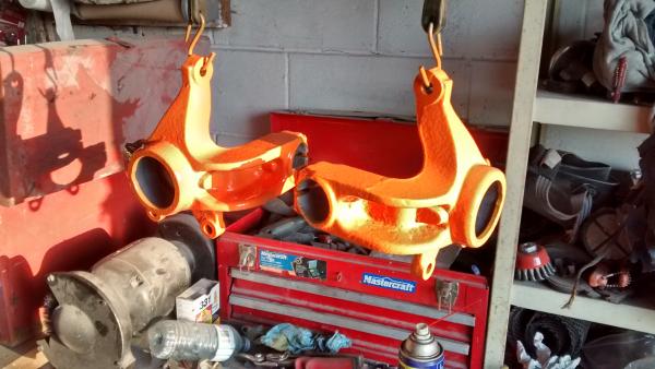

Got the knuckles all painted and ready for bearings n hubs Smile

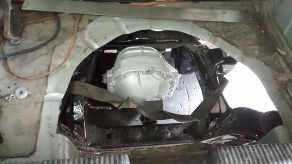

So looks like the mark viii IRS is about 1.5-2" narrower than the focus. And it fits in the back hahahaha.

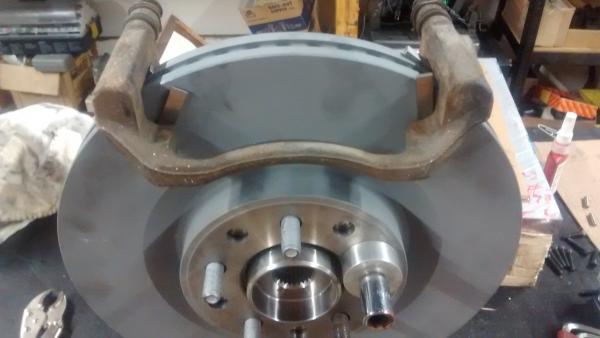

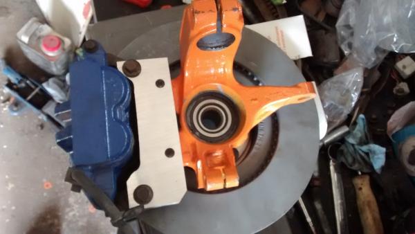

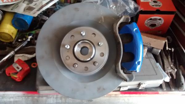

I've decided to use a different slightly smaller brake setup, 07 ford edge 12.6" rotors and Lincoln LS dual piston calipers, I've designed the caliper bracket adaptor, now its just a bit more machining and done Smile

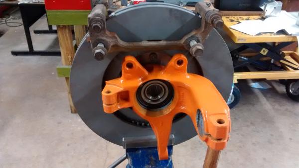

Got my prototype caliper brackets done. 1" thick cast aluminum. Thicker than the knuckles the calipers came from, should be strong plenty.

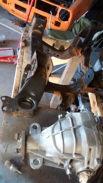

Subframe disassembled with the aluminum diff. Its amazing the size of bolt they use for control arms, then 4 little dinky 15mm bolts to mount it all to the car.

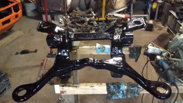

Rear subframe painted and clean Smile

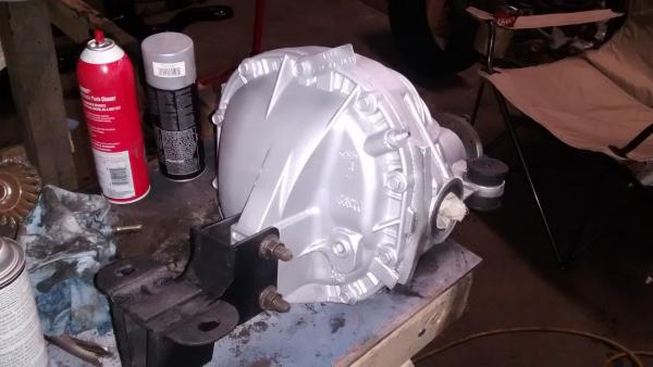

#37
Cleaned up diff and coated with color

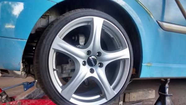

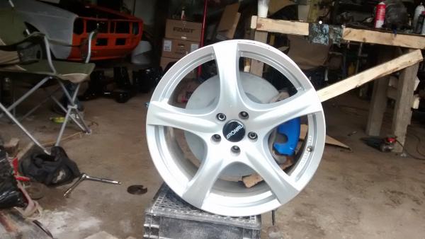

New rims with front knuckles n brakes... Looks like I need bigger brakes again :/

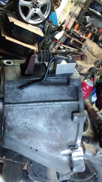

After a 34 day work week and a 4 day weekend, I have some time off to at least fit the rear end and get more swap parts made up.
I got a pair of solid IRS subframe mounts made:

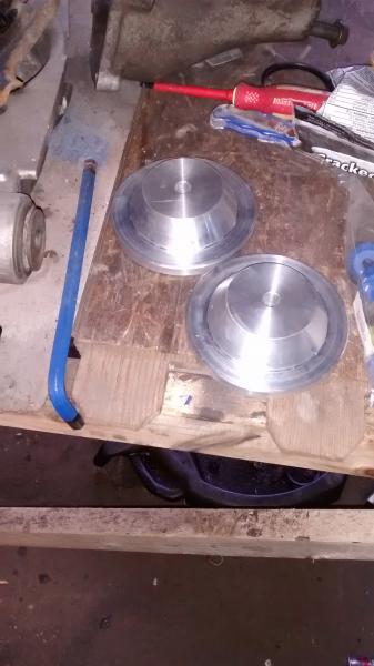

Made up a block go adapt an external slave cylinder to the t5 bellhousing:

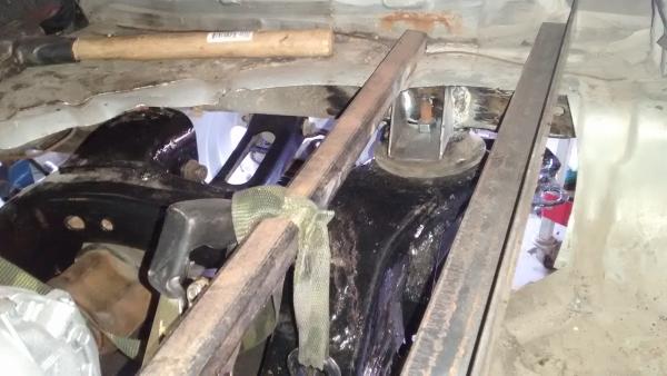

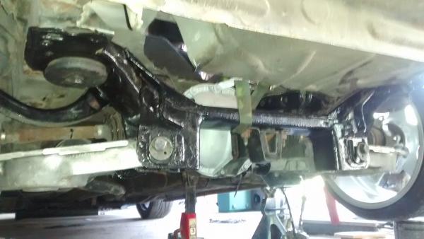

So I've got my car cut apart and fitting the rear axle. I have two rear mounts made anD welded in.
