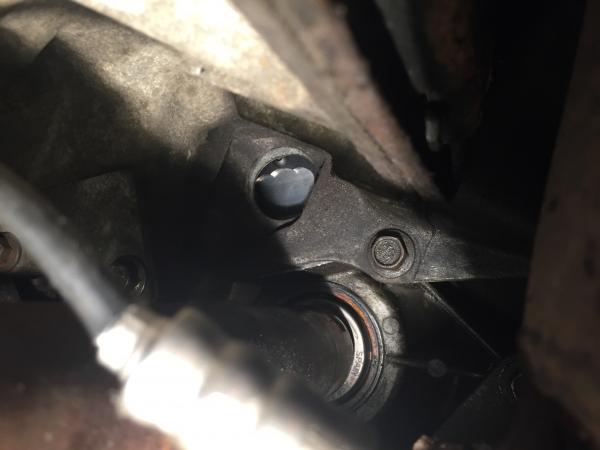

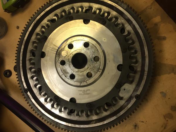

Well I have found the problem . Sure enough I was correct . The crank ring is in the wrong position there is one bigger section that has to line up with the dot . It is not lined up . Here you can see the dot in the smaller section .....wrong
Here is the bigger section with no dot .
So I'm gonna contact CFM , I would like some sort of compensation for all the work that needs to be reversed .
Here is the old one which is the correct way . I'm beyond pissed .
