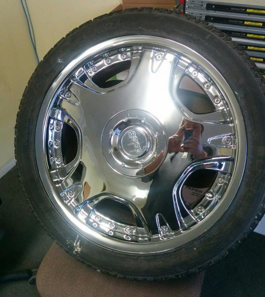

Okay so I bought a set of wheels on kijiji the other day amazingly cheap, was going to use them for winter rims but they're growing on me... Especially since I polished them and they came out perfect.
Before:
.jpg   $_27.JPG (Size: 22.14 KB / Downloads: 56)
After:

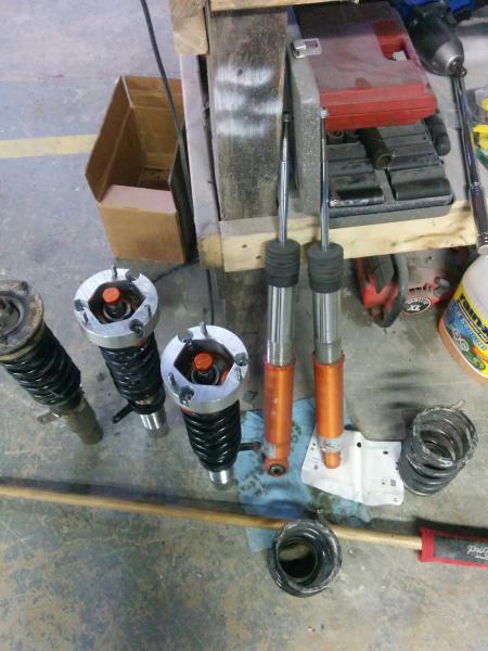

Well Ive kind of switched gears on this project, i pulled the rear end out, stuffed a stock rear suspension back in, moved it all back to stock, mostly. I grabbed an old bat inc kit for mustang calipers on 00-04 knuckles with fsvt rotors.  Bought a set of ksport 1st gen coilovers - which are sort of rare as most of the ones sold now are much different without adjustable camber/top plates, they usually require cutting the strut towers a bit to gain adjustability but they also put my car wayyy too low at the highest setting, so i made a set of spacers for the struts.

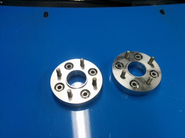

I also made a set of 1.25" wheel spacers that are hubcentric too. I also found a deal on a JRSC w/bbk, so im in the process of building a low km motor up to swap into it, keeping it FWD for now.

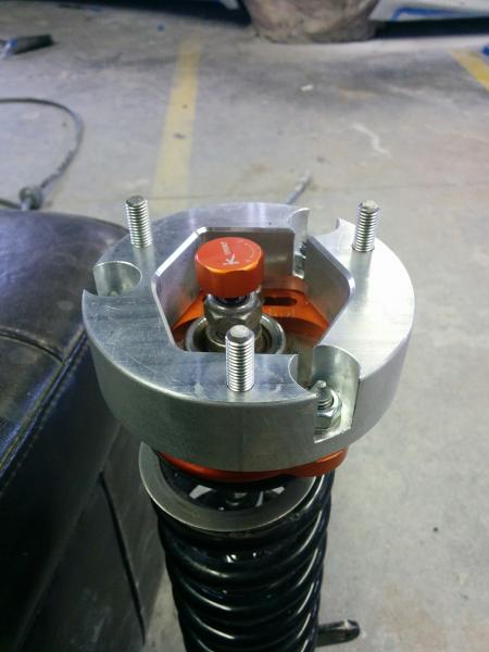

Strut spacers, 1.25" as well, also allows me to adjust the camber without hacking my car up.

The ksports I have definitely made it too low at the highest setting. Spacers also allow me to adjust the camber directly by rotating the top plates 30° vs redrilling the mount holes to gain camber-only adjustment instead of camber+castor. Also puts me in the middle sweet spot of the short shock travel.
