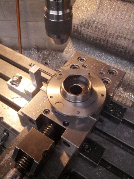

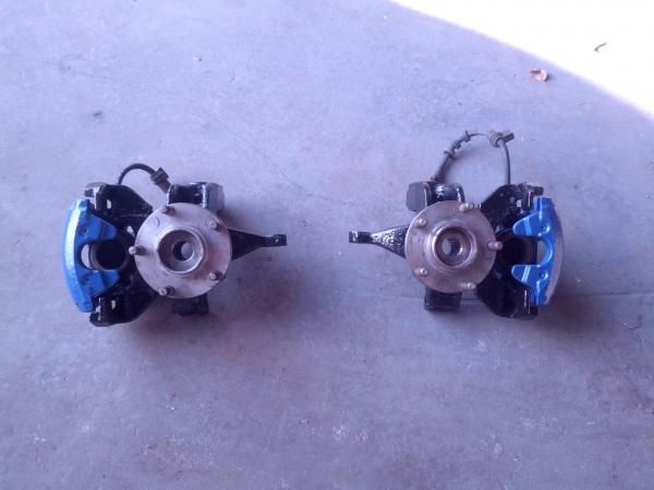

Couple sneak peeks for my 5-lug
Sooo ive given up on the mazda 3 knuckle all together, as its impossible to mate a mazda3 outer CV with a ford inner without custom made shafts, so I went and welded up the stock hubs and remachined out the 5 x 114.3 pattern in its place, using early 05 knuckles to keep my struts, upgrading balljoints, and using mazda 3 front calipers/brackets with the mazda3 front rotors. I have the rotors at work crossdrilling them for shits and giggles right now, so theyre not in the pictures yet.
